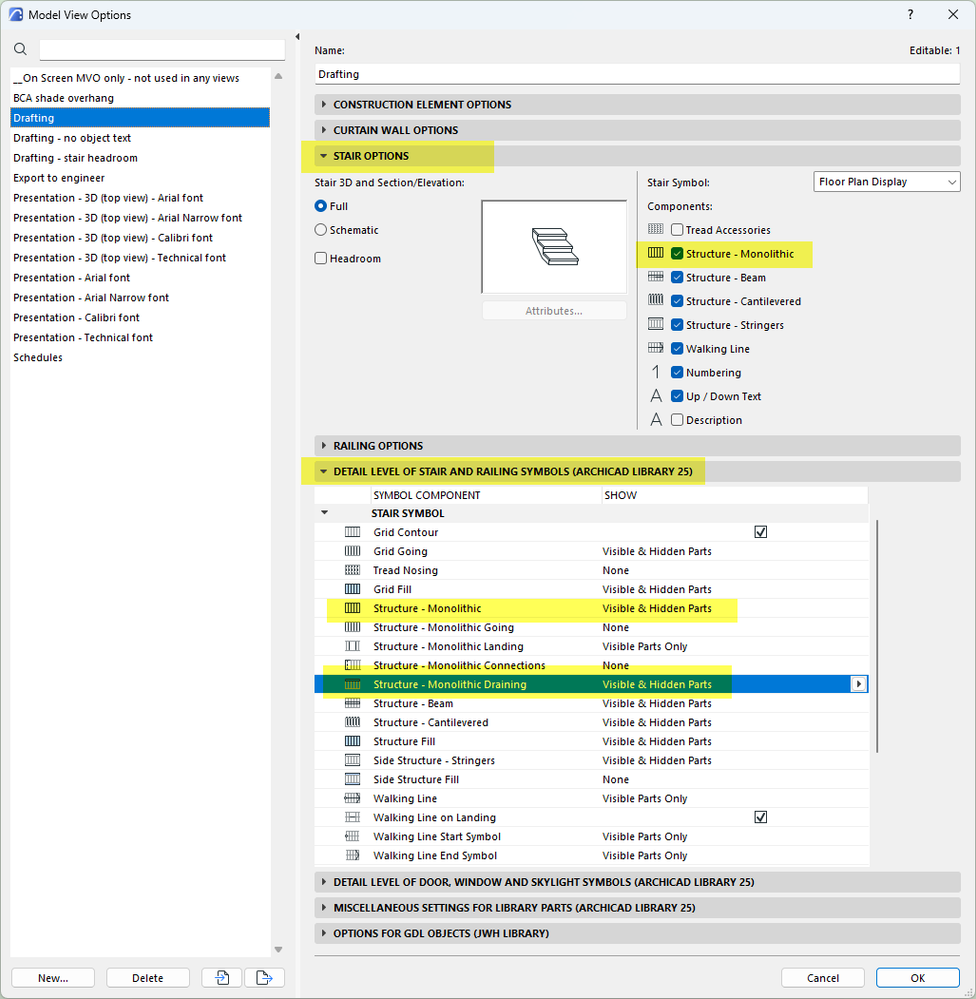

Yep, that (the model view settings) is pretty what I am doing, as far as I can make out.
The 3D stair:

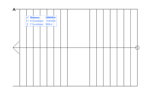

 The 2D plan view, that ignores the gutters:

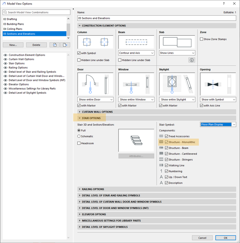

 The Model View Option settings:

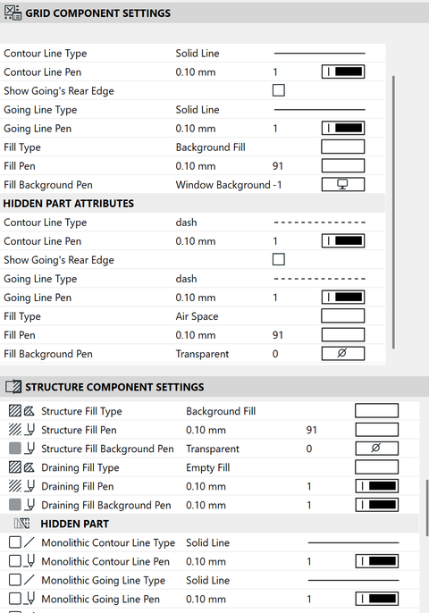

And the selected pens and fills

Also in MVO Stair Options, make sure 'Structure - Monolithic' is ticked.

I also have 'Structure-Monolithic' set as suggested under Stair Options/Stair Symbol - but it does not seem to help

Is your stair object floor plan details set to use MVO?
This is strange.
I just opened a default Graphisoft template (28) and tried with drainage on the stairs.
I can see it is there, but I can't get it to show in plan.
But you can see from my last image from my template it worked, but I couldn't control the pen colours.
And now I open my template and I can't get it to show there either.
I feel we are missing something obvious, I just can't see it.

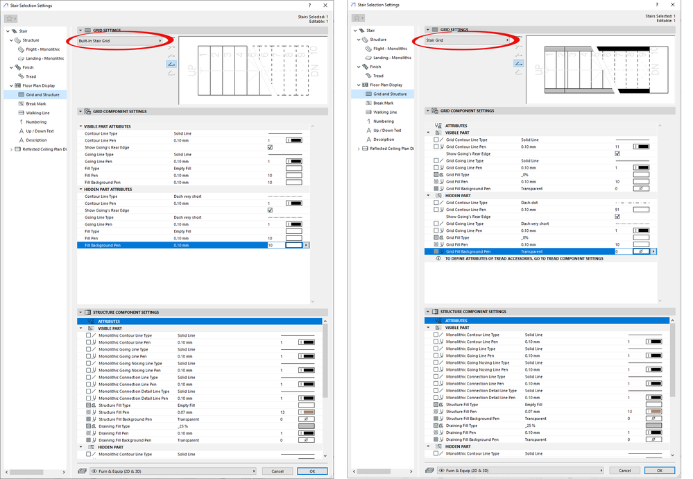

Maybe it has something to do with the grid object being used.
Built-in does not seem to show drainage but the 'Stair Grid' object seems to work.
Paul King
Mentor
@Barry Kelly Well spotted!
Yes, that Grid Settings selection made a difference (though not clear to me what other implications arise in other view contexts when using 'Stair Grid' rather than 'Built-in stair Grid', or why we are offered two such cryptic yet similarly named options at all).

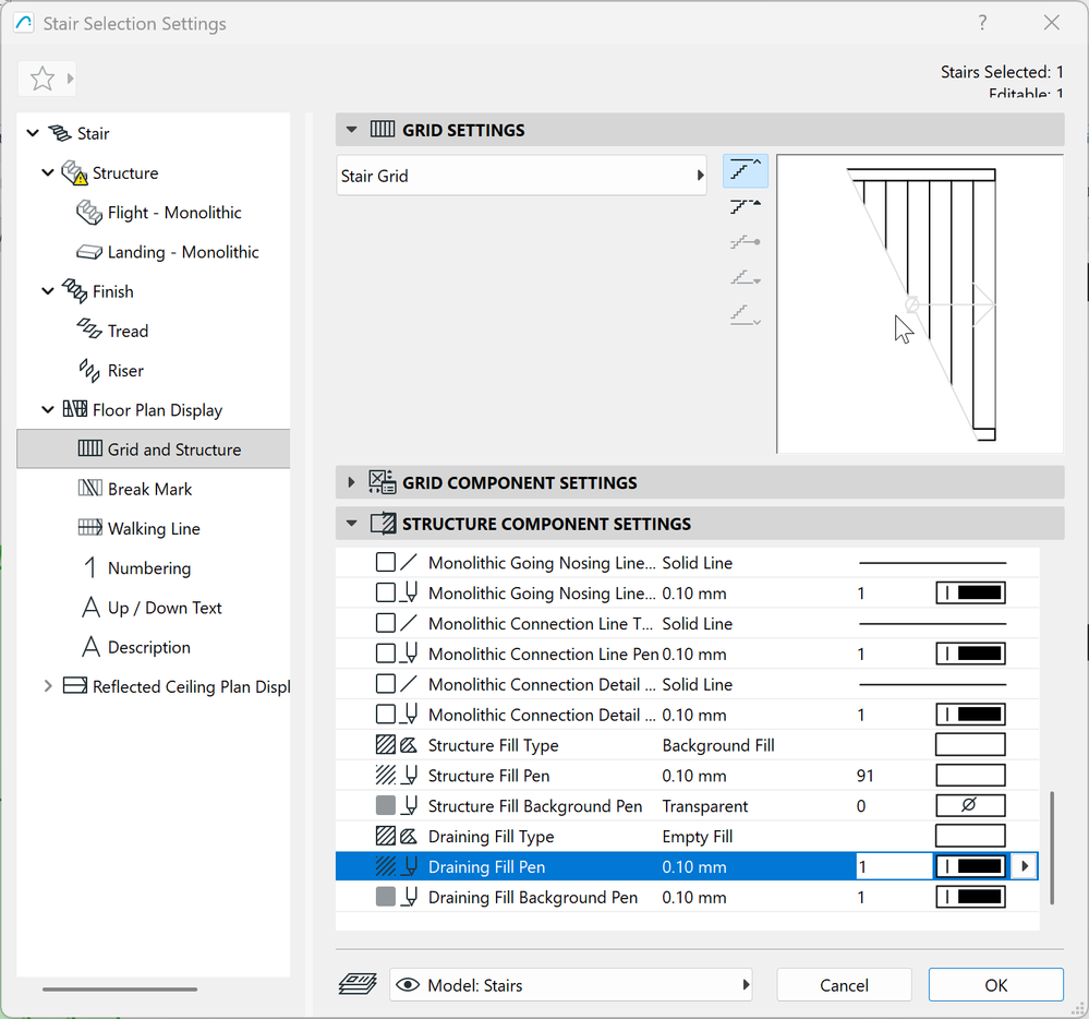

Also, with 'Stair Grid' active, I think the gutter fill pen you are looking for is here
