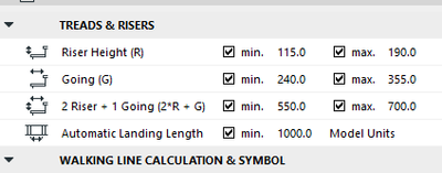

¿How can I edit the footprint of a stair by at least 2'? The program doesn't allow me, it automatically changes it to 1'1"

I think they are talking about the tread depth. Check the rules you have set.
