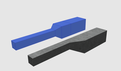

I'm trying to get a duct with a continuous straight reference at the top edge, instead of the centerline; as in the beam geometry from the attached screen shot. I found an old article that looks like it used to be an option; did we really lose this valuable modeling option with the latest iteration of the MEP ducts?
(from an old article using the previous MEP plug-in and library: https://help.graphisoft.com/AC/24/INT/_AC24_Help/086_MEPModeler/086_MEPModeler-6.htm)
I need the blue duct to look like the gray beam:

Like below? If so its just a question of playing around with the individual segments reference axes until it looks right.
Patrick M
where is the segment reference axis setting?

looking at the duct segment, I see this:
and there doesn't seem to be a pet pallet option to adjust either.

Oh - I assumed AC28 where this particular fragment of development managed to get pushed in - you can't do that in AC27...

Sadly, this simple basic function of the duct didn't give us in 27.3.0.
