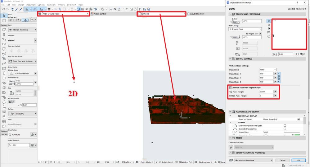

I have imported a .xyz point cloud file to Archicad 26, it is displaying in 3D view but not in floor plan.
I have looked for a solution everywhere but couldn't find anything specific.
Do you have any idea what the problem may be? I need it displayed in floor plan too

Hi sinh van,
You have set the floor plan display to "Home Story only" and the Point Cloud is placed in 0. Ground Floor with a negative Value of -3773. Your floor plan display is set 0 to 50000. So you have to move your Point cloud up above
Project Zero or set the display to "All Storys" and look in -1 Srory.

Thank you!!!!!!!!!
