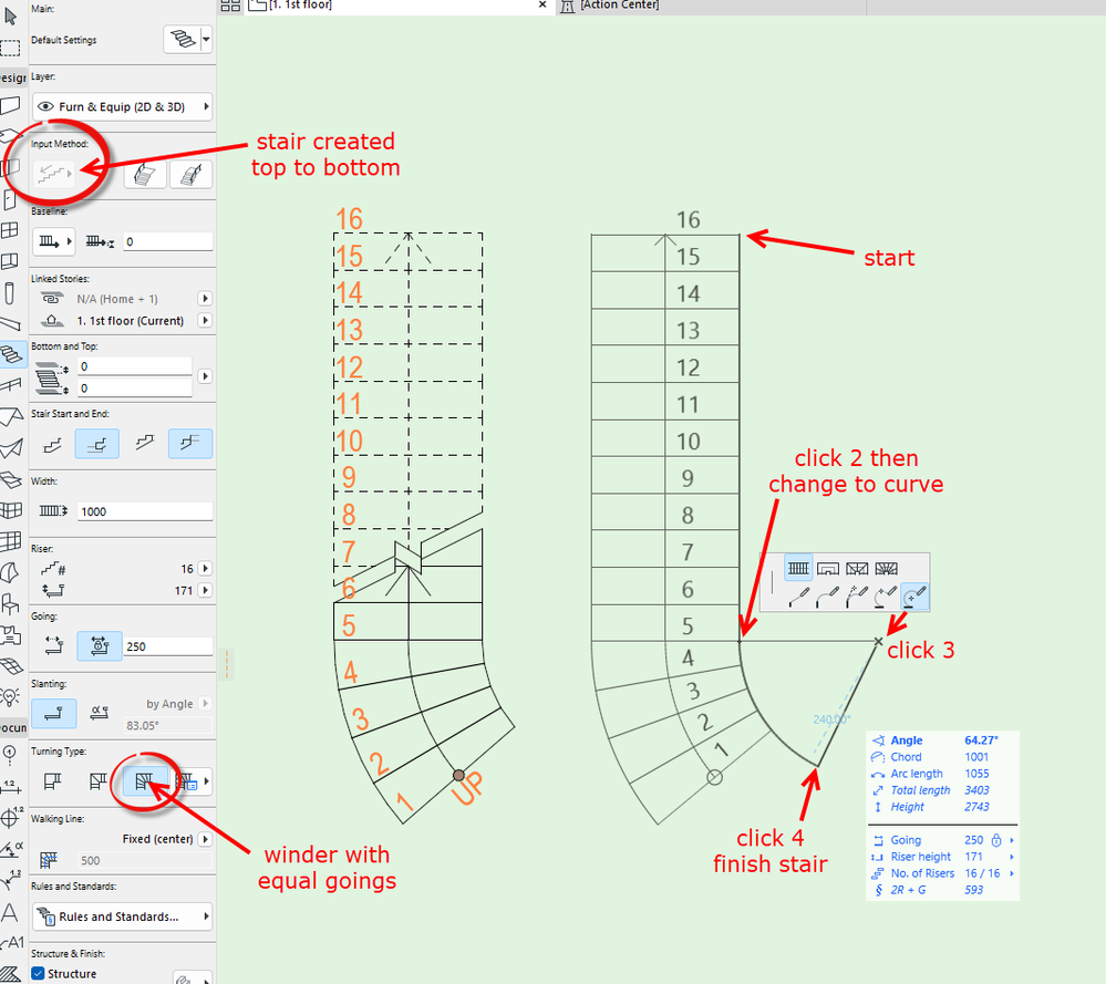

So glad you got it working.
I kept having trouble getting the 5th riser to be horizontal and the curved goings (1,2,3,4) to all be equal.
I guess it is a case of knowing exactly where all the critical points are.
Then I just remembered you can model a stair from top to bottom.
You know the top start point.
You know where riser 5 is.
You know where the centre of the curved treads is.
That is all you need to know, the last point of the stair is automatic.
So in 4 clicks (5 if you include changing the pet palette), you can place the stair.
But as I look at this again, the riser between 4 & 5 is not exactly horizontal.
Maybe I still did not pick the exact points to get it all lined up properly.
It is close though.
