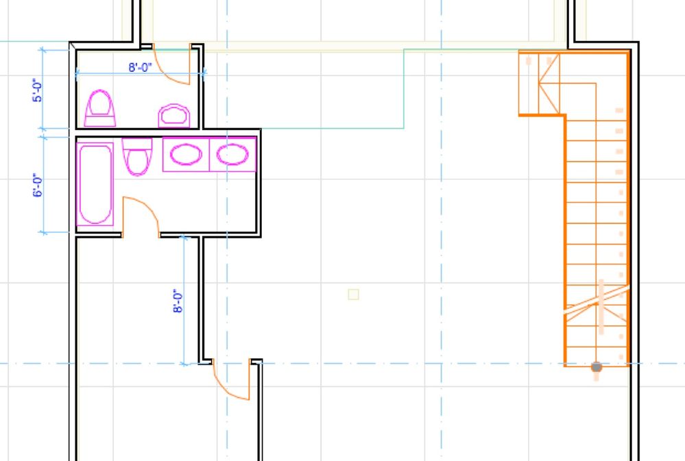

how do i reverse the arrow symbol? and have the dn text on the other side?
i rotated the stairs so it's going down to basement. it sure took me an hour to get this out...struggling..

Look in the 'Text Display' tab of the settings. The 'up and down text' also effects the arrow direction. Try setting it to 'Automatic' so it points up from the lower floor, and down from the upper floor.
