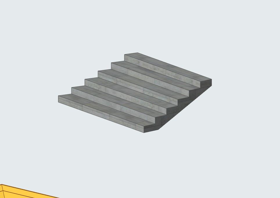

In the file I'm working on the stairs have no thickness and I dont know how to fix it.
I've copied stairs from another file that shows correctly in 3D, but when I paste the stair the thickness disappears too.
It doesn't seem to be an MVO issue.

Nice project shown first, and the naughty project shown second.
The wood stair is originally created in the nice project and copied to the naughty, and the concrete stair was originally created in the naughty project and copied to the nice.
Nice project:
Naughty project:
Naughty project elevation is correct !?!

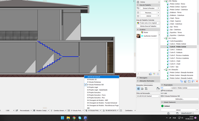

Goedertg

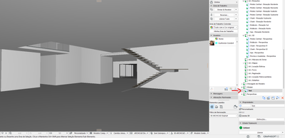

Hello friends, I was having the same problem with the 3D stuck in a wrong MVO and this worked for me (for now):
Go to a saved Plan View (section or floor plan) > change the MVO to default > select the stairs > F5 > (mine came back to normal) and then F5 again for the whole project to appear.
This is the only way that I am able to see the full stairs and railing in my 3D view, but even if I save it, If i go to a view with different MVO and back to the saved 3D View, it comes back to the wrong MVO, even if I change it to default.
Don't know if it helped, but hope it is fixed soon.
