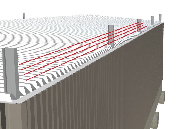

i'm having a problem by drawing a steeldeck roof on an industrial building.
I tried to draw it by the object 'Profiled Sheet Inc 13' from the archicad library 2010. The problem I have is the direction of the slope. I want the sheets to lay in the other direction put I can't find how to do this?
You can see on the image included what I mean. The sheets should lay in the direction of the red lines.
Thanks!!

This object needs an additional parameter for the "rotation about longitudinal axis". Maybe someone of the GDL gurus on this forum can do it?

Strangely, the code is in the 3D Script as an option, but was not implemented (I don't know if this wall because there were odd problems with certain parameter settings that could cause issues the author did not want to work through). Open the library part, Save As.. a new object (to preserve the existing object), go to the 3D Script, and go to line 176 where you will see:

This is an if/then statement for the direction of the corrugations in the sheet. The simplest solution is to reverse the commented out sections so the code reads like this:

This object will only do the horizontal corrugations, like the original only does vertical. If you want to spend more time, you could uncomment all the code and add a parameter hor that controls whether the corrugations are horizontal or vertical.

Try OBJECTiVE. It adds tools to easily cut/rotate objects in 3D. With your roof, for example:

Note that you can rotate any number of profiled objects simultaneously (about a common origin) so you could cover an entire roof easily. Out of interest, why do you want the profile to run against the slope - won't that cause ponding problems?

Another simple solution is the Complex Profile: create a section along the roof slope the width of each deck panel sheet and lay them down across the roof slope using the beam tool.
