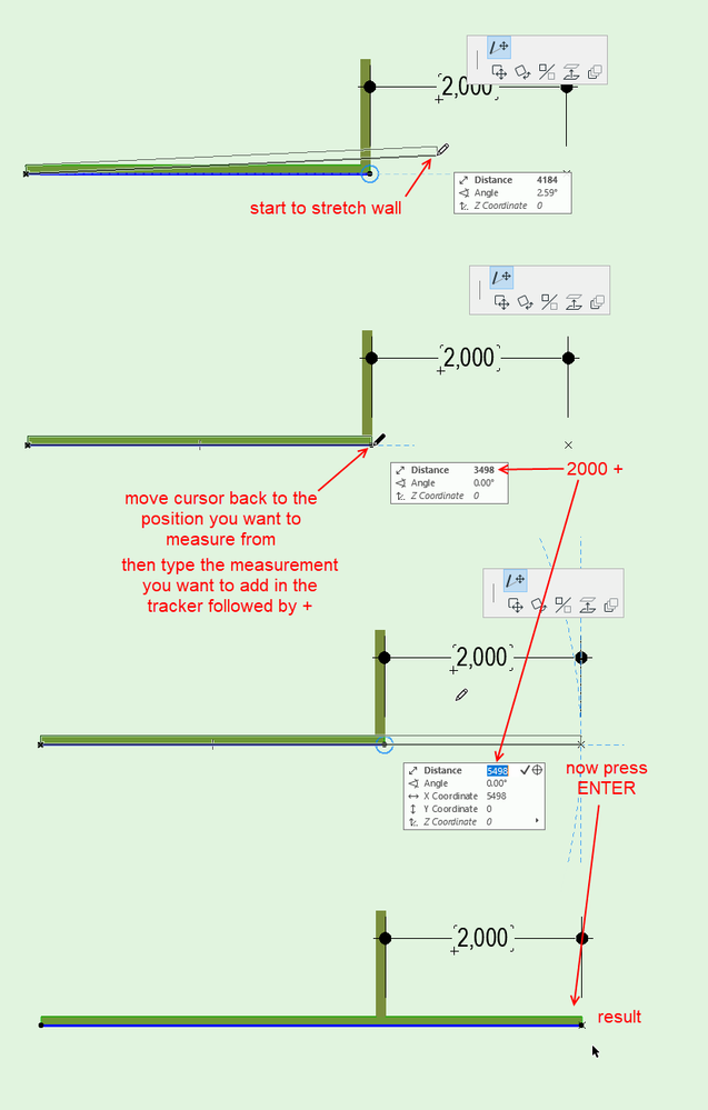

read most if not all of the posts i could find on stretching and have not been able to solve? i have a beam that simply needs to be stretched 12' on either end. seems yesterday stretching elements was not a problem. for some reason when i try to key in 12' it gives me either a stretch down near the origin of 0,0 or it gives me a beam that is exactly 12' long or it moves it to the left of the end point of the beam itself? i have gone bonkers selecting/deselecting switches in the tracker and work environments to the point i have no clue what is what anymore. any suggestions?

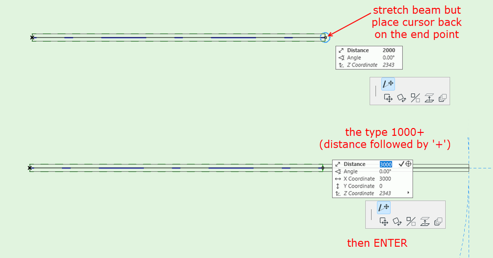

If stretching is relative to the origin (you will see a line linking to the origin), then turn on 'Relative Coordinates in Tracker' so it will be based on the other end of the element.
And to stretch a given distance from any point, stretch and move cursor to that point then type distance required followed by '+' to add the distance or '-' to subtract the distance.
Zdenko

hear is an example of my lack of not understanding how to stretch? i can easily stretch lines, move, drag a copy by inputting dimensional information. all i want to do is stretch the ends of these walls by 12"? i have tried relative on/off but obviously don't understand such a basic command?

Here I am stretching a wall 2000mm - you would just use 12"+ instead of 2000+
Zdenko
ok now i see what the difference. but i don't recall having to place the pencil at the starting point to stretch a particular length. i could have sworn that i have been able to stretch the elements by simply making the element active, selecting node/point and move the cursor in x or y direction, using shift or visual, and then key-in the distance without the "+". regardless, i will pay more attention to my process.
