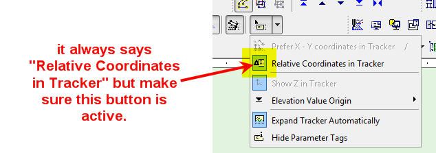

It will always say "Relative Coordinates in Tracker" in the pull out menu but make sure the little icon next to this is active.
If it is not I get the behaviour you mention.
If it is then the user origin swaps to the other end of the wall and you can stretch as you want to.
Maybe there is another setting I am missing somewhere.
If the "Relative Coordinates in Tracker" is turned off then the wall stretches from the drawing origin and not the beginning of the wall.
Does your user origin move to the strtching end of the wall when you hold SHIFT or does it just stay at the beginning?
Here is an image of 15 with the user origin moving for me.
To me this is normal and I don't know any other way to stop it other than what I have mentioned already.
