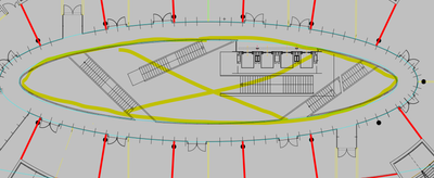

I need to substract an elipse form shape from a Zone. In the picture attached, the gray is the zone, and highlited is the area I need to substract. I can´t do it with the regular tools option I have to substract and add area for the zone. Any ideas?

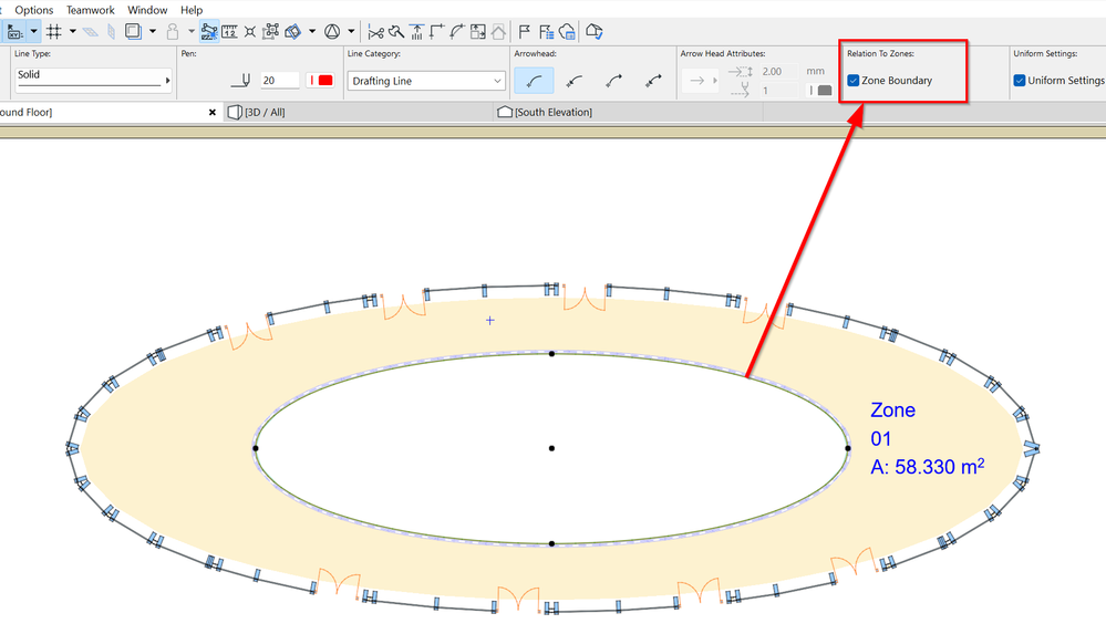

You can draw the ellipse with the Arc/Circle drafting tool and activate Related To Zone to Zone Boundary. Then use the zone construction method of your choice. That ellipse can be in a hidden layer if you want.

Thanks for answering. The problem I see with the method you described, is that it will actually only work if I use the zone construction method were I have to click in the center of the space and automatically the space area is detected. I am measuring plans that comes from other softwares than Archicad, so most of the times I have to select the zone´s manual construction methods, and after that I substract what need to be out of the measuring (void, columns, etc) In some specific plans I can make all the lines to be "zone boundary" and then use the automatic method of construction. It would be great if there is a way of selecting closed polylines inside a zone and substract those, so if the zone have a hatch this won't appear in the substracted areas, but it doesn't seems to be possible.
