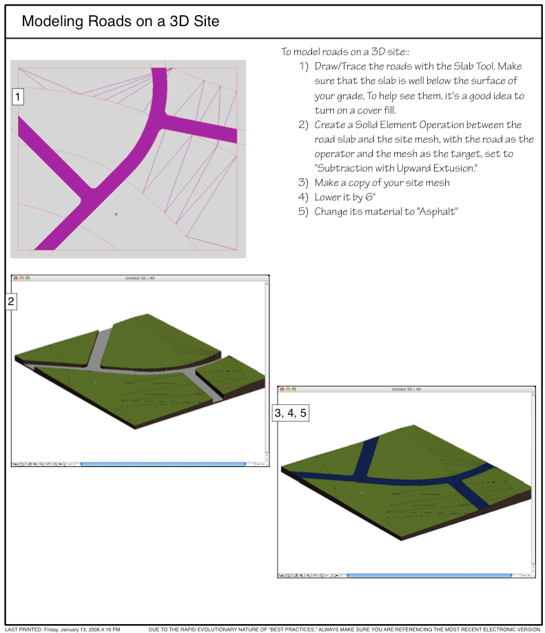

I've attatched a picture to illustrate the problem.

Try this:
The "it" referred to in steps 4 & 5 are the copy, not the original.

Absolutely wonderful! Works perfectly - and it doesnt seem to bog down the system with having two mesh objects in the file. I dont have the time on this project to try it out, but is Architerra worth the trouble learning if were going to be accurately modeling sites?
Thanks again
Thanks again

I cannot take credit for this one. A guy I work with came up with it. It totally blew me away at how simple it was.
He even went so far as to have one for sidewalks and one for a bike path on one project.
