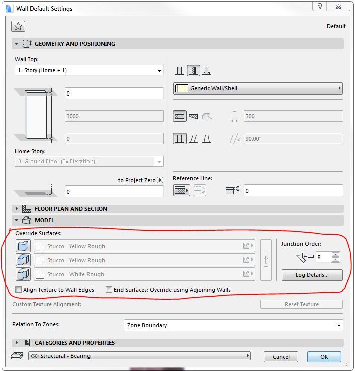

I'm designing a hotel on the archicad student version and have managed to get most thing done ok, however when I click on a wall or a column it only puts the surface material on one part or one side. Is there a way I can get the whole column or wall to be covered in the same material?
Quite new to this so hoping there is an easy way of solving this!

I'm Assuming that when you say "I click on a wall or a column" you are using the surface painter, this is the way this tool is meant to work, if you want to replace the surface on a entire wall then, you should go to the wall dialog and change the surface override there (see pic) also for the column is true.
But just as a side note, depending on what you want to achieve it could be a good idea changing the wall composite with the material you need instead of painting it unless you are changing only the color, remember that a surface in Archicad is only how a material looks, and a material is a representation of a actual real material that has more properties that only how it looks.
Thanks so much - that worked!
I was on surface painter yes but it would only cover one area but now I know why.
