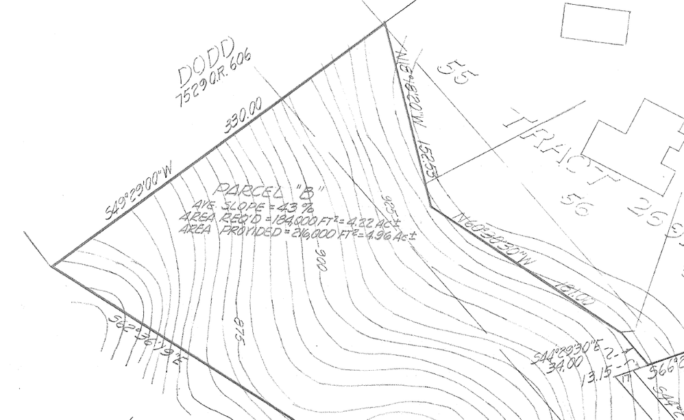

So..was sent this survey.
it was "hand drawn" a while while back.
has contours, property line lengths and property line "angles".
I know in acad...you type at the command line "145'@15D33'21"W" and it'll project that specific distance "and" angle and you can create your property line with the correct property line lengths and angles per the survey.
What are the command line keyboard strokes that you can use to do the same think in Archicad?
I've usually just been handed a DWG file, used that to draw over my property line pline, then create mesh from that "loosely" based on the contours but on a hand drawn property line map...how would you do the property lines different angles?

Rob,
Easy-peasy, man! Here's how it works:
The bearings are given east or west deviation from north or south. So:
For a mete expressed N 20d 30' 15" W, you would assume a line bearing due north, then rotate it 20d 30' 15" to the west, using it's southern endpoint as the point of rotation; i.e., it would rotate to the left on your screen.
If the basis bearing is South, you'd swing the line from it's northerly endpoint; to the left for westerly or the right for easterly.
In the US versions of AC, there's a setting for 'Surveyor's Units' on angular dimensions in the Preferences menu. In that case, you can type in the mete values right into the angle input box of your line command.

so...just to be clear..I actually "type" just like you typed it?
with keyboard strokes as "N 20d 30' 15" W"
Just like this...with the spaces in between the letter and number?

Rob,
No spaces. I just did that so it would look clearer.
When I do it, I start a 'line' command, get it kinda' pointing the right way, then just hack the numbers in the 'a' box, and input the bound (length) in the 'r' box. I never really type in the whole thing.

Easy. Start your line, constrain cursor to North direction, hit D (or R) and type length in the appropriate field, hit A for Angle and enter angle figure, followed by - (minus sign) before hitting Enter. This will measure the angle clockwise from North.
Also, what works here in Metric world at least, when entering angles (with preferences set to Degrees, minutes and seconds), use spaces between numbers, so 20d 30' 15" is just 20 30 15
