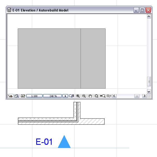

archimax wrote:No. It is a long standing wish. Having said no, you can overcome this annoying bug by using a wall end.
/... Is there a way to get rid of the vertical line on the facade while keeping the plan intersection clean?/.....

Erich wrote:No trick Erich. The 2D is just a small line for location. I turn if off in plan
/...... Interesting trick. Are you just using the bog standard wall end
or is this something different and if so how?

archimax wrote:With our Wall End there is
/... Regardless of a small inaccuracy in intersection
that wall end workaround worked well for me this time (for 1:200 scale). /....

laszlonagy wrote:Thanks Laszlo, another way to "skin a cat"
Here is my trick. /....
