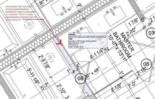

...THAT DARN 'ELUSIVE' REF DOT...ORANGE BALL.
SEE ATTACHED.
THE REFERENCE DOT THAT SHOWS UP (WHICH IS MOST USEFUL BY THE WAY) WHEN MOVING OR REFERENCING GEOMETRY OF AN OBJECT, CONTINUALLY MOVES AND DISAPPEARS WHENEVER i TRY AND TOUCH IT......HOW CAN YOU "LOCK" THAT DOT IN PLACE JUST LONG ENOUGH FOR A USER TO TOUCH IT AND SELECT THE OBJECT AS THE REFERENCING GEOMETRY???

You have to run your cursor along the object it is referencing. If your cursor strays too far, it disappears.
Hi Rob
What works for me is to hit "Q" on the keyboard. That's the shortcut that forces the highlighted pale orange dot into a guideline.
See if that works
Cheers

"Q" clears my guidelines (default, I think). Check your shortcuts, Rob, and assign as necessary.

Shortcuts can vary between Mac and Windows. If your signature had relevant info in it you might get better answers
But as I said, if you run your cursor along the element, the "blob" will stay till you get to it.
Yep, "Q" is the default for force guide lines in PC. What is it on MAC?

Show / hide guidelines

Have you installed the latest (3487) hotfix? I believe this fixed some issues with guidelines. If you added this information to your signature......
