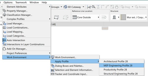

I just installed AC28 on a Mac Apple Silicon and a Mac intel. Both are missing the MEP Profile. Did someone drop the ball on this, or did I screw up?

This could be either a mistake or a bug. Otherwise, the "product version," shown below, which is related to the ArchiCAD 28 USA Template, has not yet been completed:
While waiting for the final version, you could replace it with another one like that of the United Kingdom, as enclosed, for example. I replace mine with that of France:

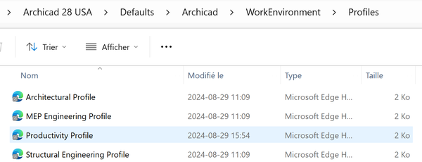

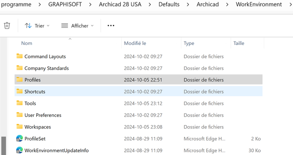

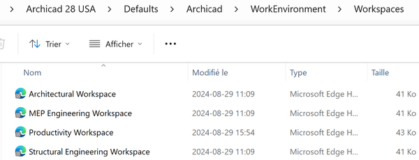

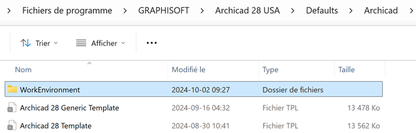

You might also check into your ArchiCAD "defaults" folder:
ArchiCAD 28 > Defaults > ArchiCAD > WorkEnvironment > Profiles and > Workplaces
