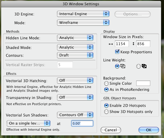

This is not likely due to your 3D settings.
It is probable that your mesh is either too complex for your hardware or that it is geometrically flawed and the machine is hanging up on the errors. Since the program hangs I would suspect the latter, but a G5 is getting to be a bit of an old machine to be running ArchiCAD so that could be part of the problem as well.

After importing the surveyor's topo and boundary file, I noticed that not all contours reached the boundary limits. Since the contour lines are polylines, I added to them in order to extend them to the boundary lines and treated them as contours. Is this appropriate? Prior to posting I was considering starting over in the event that there was an error on my part. But of course I don't know what that could be. The site has a 32' rise and it took a good deal of time to magic wand the contours (almost all in the surveyor's drawing were broken in order to insert elevation values). And then to assign elevation values. The further I went along the slower the computer performed. Could the fact that the surveyor's lines were not continuous be a problem? I did not join them with another line. And I assigned the same elevation values to the isolines either side of the break. Also, as I went along I would look at the progress of the model, and after about eight feet of rise it would take few minutes to reveal an image. I then changed the 3D settings to hidden line to see if that would make a difference, and finally to wireframe to no avail.
