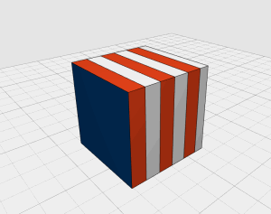

    • Hard or Soft Edges: in the Info Box or Morph Settings, any edges can be individually re-set to be “hard” or “soft”.
  • Advanced Texturing As with other 3D elements, if you have applied a material that includes a texture, you can use the Align 3D Texture command to fine-tune the origin and rotation of the texture pattern. For the Morph, these options are also available individually and separately for each face.

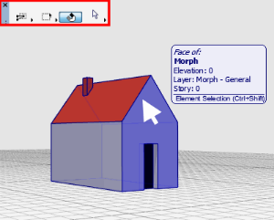

Sub-Element Selection
Select the Nodes, Edges or Faces of the Morph:
• with the Shift+Ctrl+Click.
• or using the white arrow from the Info Box.

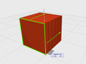

Box Stretching
Use the Box Strech command to transform the shape of you Elements.
• Strech from a face to achieve a one-dimension strech.
• Select an Edge to constraint the Stretch command into a Plane.
• Pick a Node for a free transformation.
