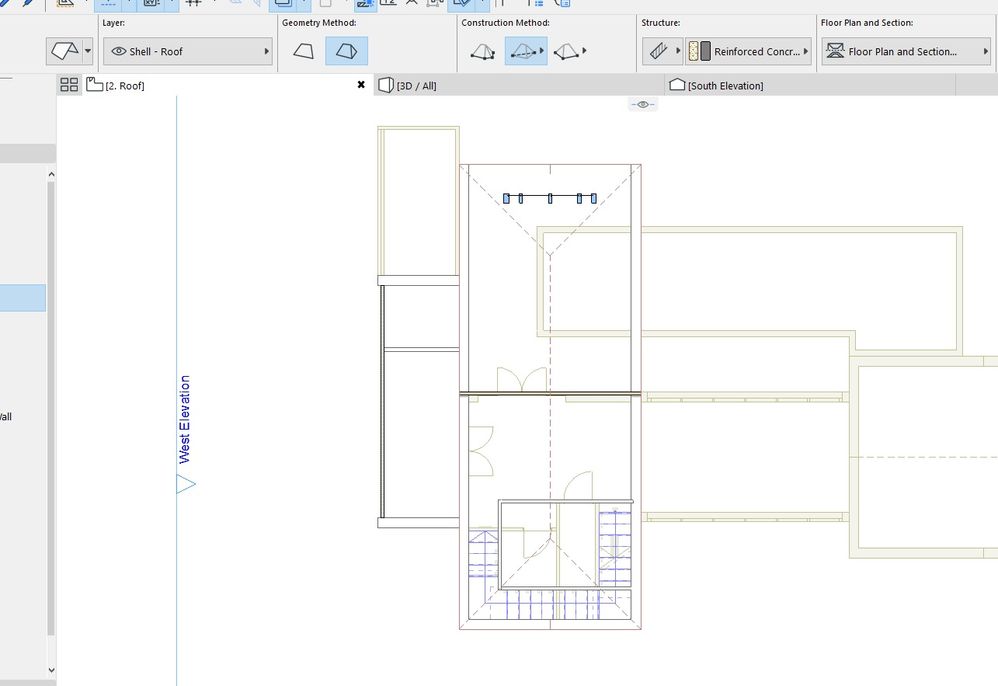

The Roof looks different than what I first created it in the Floor Plan.
Hi, I wonder if anyone has had the same problem.
I created a gable roof that looks alright at first in the floor plan.
But for some mysterious reason, it doesn't look like a Gable roof at all later on. As you can see, it looks a lot different than when I first created it.
Although, it looks fine in 3D View. So I'm wondering if anyone would be so kind to give me some advice to fix this, thank you.

Are you talking about how it is cut in your second image? That would be due to your Floor Plan Display setting for the roof together with your Floor Plan Cut Plane (FPCP) settings.
If you are not wanting it to be cut on that story, you can either create a View with a different FPCP or change the roofs Floor Plan Display to Outlines Only.

Thank you, sir. It looks a little bit better now.
