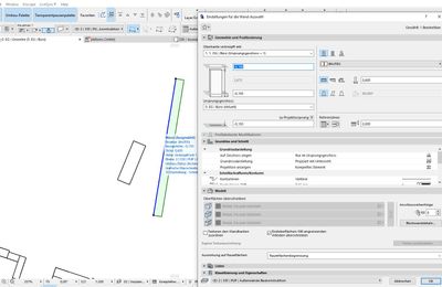

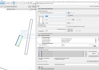

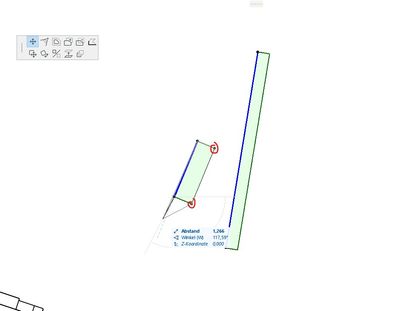

All my walls have now 4 selectable corners (instead of 2) and they don´t connect with each other any more. I also can not extend them normally, it is always pulling one corner.
Anyone know how is that possible?
I didn´t choose in the settings that corners of a Polywand can change...
I am also attaching printscrean of the settings on the right where we see how the wall should be and on the left the wall that is changing corner, which I don´t want.
Thank you for any suggestion!

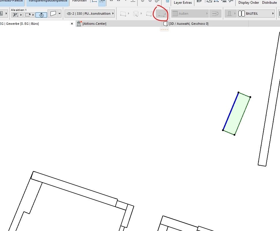

Yes you have accidentally changed your wall to a polygonal geometry method.
As far as I know there is no way to change back to a standard wall other than re-placing it (re-modelling it).

I just noticed that the walls changed to another geometry method of drawing but have no idea how. I drawn them with the normal option, then they changed (no idea how), but now I can´t change them back ...
