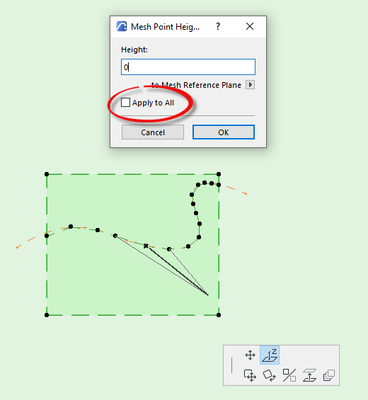

When I click to elevate the point in mesh, the pop up box don`t appear to I put the elevation measure. Can anyone help me? I need to elevate all the points on line at the same time.
1 REPLY 1
If you mean you are not seeing the dialogue where you can choose all nodes on the contour to be the same height, I don't think you will se that in 3D.
Try in the floor plan.
