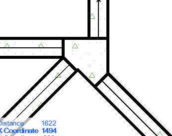

This is a floor plan. How should I draw a wall like this?

If you want walls with skins, then regular composite walls with a column for the connecting parts.
It will be rather tricky to get walls to join in that configuration.
Or if you just want a wall mass, you can use the polygon wall geometry method and make the wall any shape you want.

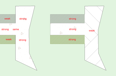

The polygon wall geometry method does not combine with other walls.
Is there a way to combine them?
AC27 on window 11
If the polygon wall has a building material strength equal to or weaker than the composite wall, then there should be no joining line.
