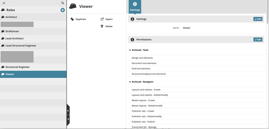

cuba
When you log into the bimserver, you can assign different roles to different users. The roles can be assigned different permissions.
This way you can prevent inexperienced users from accidentally destroying your drawing.

ryejuan
just make sure you assign that user the proper role.

Yvonne
The issue is not the role. The user was able to make changes and add new elements to the file one day and next day he couldn't. It was solved it by leaving the teamwork file and re-joining.
