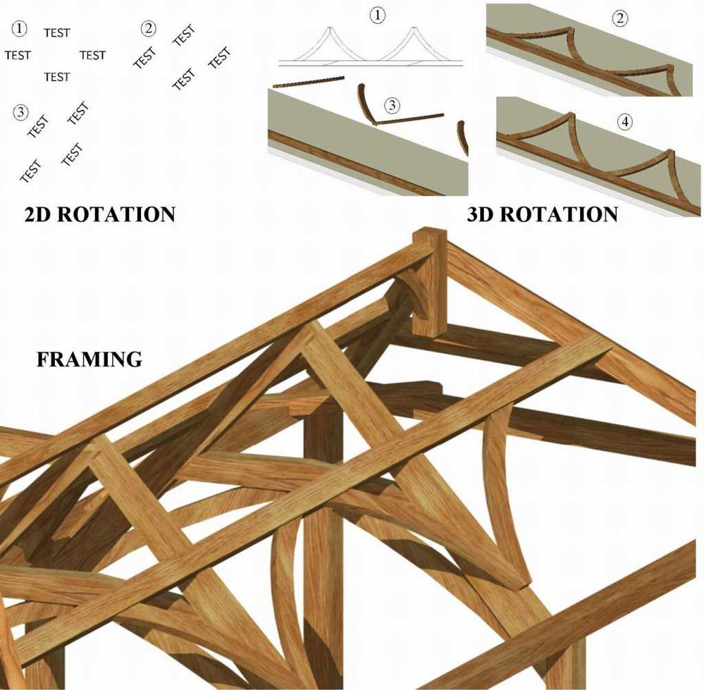

Let's look at this another way - what would you say if ArchiCAD had no 2D rotate tool? It is still possible to produce the rotated image, so in theory we don't really need it. Every object could have a 'rotation' parameter like text does, but see what happens when you use it (refer to 2D ROTATION in the example image). You start out with some text (fig 1) and you want to rotate the whole selection by 45 degrees. But see what happens if you use the 'Text Block Angle' setting (fig 2) as opposed to the rotation tool (fig 3).
The same is true in 3D, only worse - especially when the rotation has to combine 2 planes (see the opening query for this subject http://archicad-talk.graphisoft.com/viewtopic.php?t=5906&start=0&postdays=0&postorder=asc&highlight=). Refer to '3D ROTATION' to see what happens to a timber selection (fig 1 & 2) when I try to rotate it by a parameter alone (fig 3) as opposed to using the FrameWright 3D rotation (fig 4). Note also that an example like this is very easy to edit from an orthogonal viewpoint, but extremely difficult in 3D (consider the placement of the curved braces or defining the cut plane for the scarf joints).
Then consider the assembly in context (FRAMING). If you look carefully you will note curved braces, cambered tie beams, tapered rafters, and more. This would be very challenging to model in ArchiCAD alone, but can be easily assembled with FrameWright by users who only know the basics of CAD. And this is what they want - they want to be framing experts, not computer experts. Grappling with GDL, property objects, databases, etc, etc. simply wastes time and energy.
