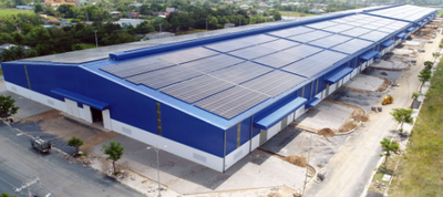

I have some questions about modeling for roof and wall in Factory project
1) How we can modeling tole sheet for factory for wall and roof with one layer is tole sheet?
2) How we can modeling wall and roof is sandwich panel as below
3) Other Accessories: Curves Eaves, Flushing Trims, Gutter and Downspout
Thanks All
