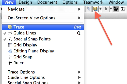

If you go to Options> Work Environment> Keyboard Shortcuts there is a button within that dialogue to "Show shortcut list in Browser" from where you can print out your entire shortcut list.
You don't really want to have the Trace Reference (formerly Ghost) turned on unnecessarily as it will slow things down. My shortcut (default as far as I am aware) to turn Trace on and off is Shift+F2 (in AC18), or click on the button the arrow points to in the image below.
