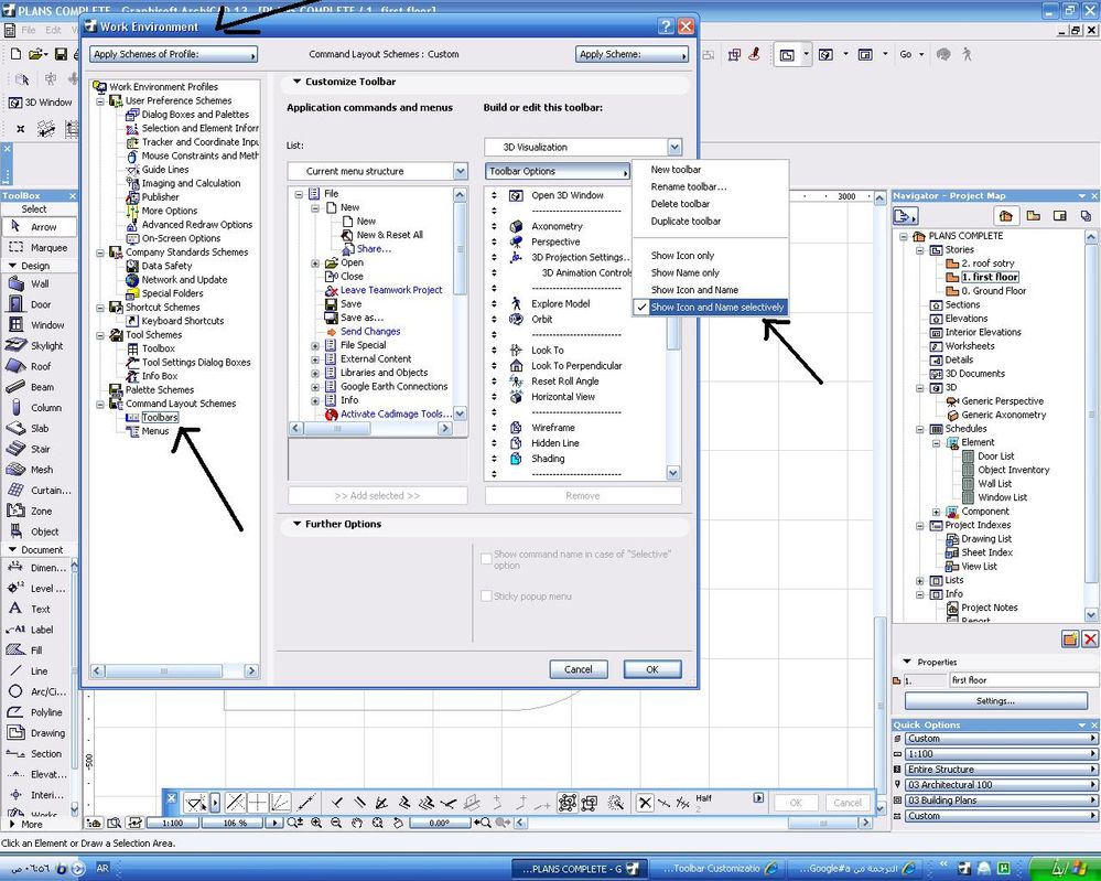

I'm sorry for the delay in reply
This picture shows the solution
Thank for your help, CIVIL_ALI,
Unfortunately the problem was not resolved. I have attached photos, they're not the best as I had to take photos as opposed to screen capture.
