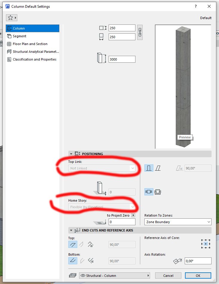

Hello everbody ,
i am a revit pro, switching to Archicad ...
i have a little problem setting a column as favorite , the problem is : i need to link it by top link. but it is impossible to do it .
someone can help , have a solution this problem please.

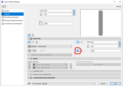

Is height set to fixed or flexible under Segment>Structure? You can't link if fixed.

@sma4bim You cannot link to a top story if the current story is already the top story.
sma4bim
Of course,
But in my case i am setting a column as a favorite, i didn't place the column yet.
I just double click the column tool to set.
I don't know why I have the problem, the file is downloaded from Graphisoft site (tutorial).
When I open a new file , the problem doesn't t exist.
So I guess it is a parameter somewhere to fix.

@sma4bim Try moving to the ground floor plan and then changing the linked story values.
sma4bim
Same problem,
I can't set the linked storey (top and home)
hevi
Ace
sma4bim
Thank you ,
Indeed that resolve the problem.
