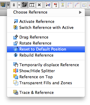

Not sure how it would have moved on its own, but there is the option to "Reset to Default Position" to restore it to its original position
magic! thank you - problem solved. I just wonder how I managed it.
