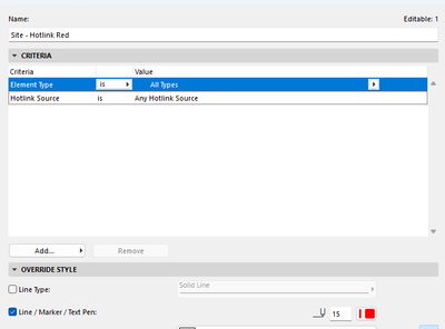

I'm trying to get a hotlink module to fade into the background. The hotlink is a survey and I want all of the lines within it to be on a particular pen, kind of like a trace reference, where you can fade it i and out...

you can use a graphic override to make all hotlniks (or a particular one) have the pen, line, etc. properties you wish.

beautiful - thank you!
