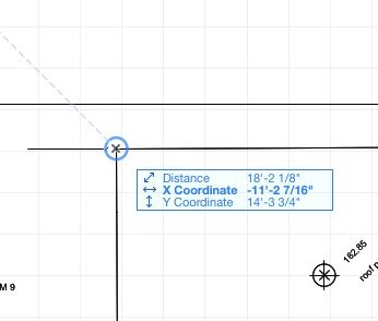

Previous to AC20, I was able to press Shift Option (Mac) to reset numbers in tracker window to 0. This function doesn't work in AC20. Sometimes it works if keep clicking at the point where I need to set to 0. Sometimes it doesn't.
The coordinate input bar window at bottom, however, always sets to 0 when I press Shift Option. What's happening?

I am not sure this will solve your issue, but take a look at Work Environment > User Preference Schemes > Tracker and Coordinate Input > Show X-Y Coordinates relative to User origin in Tracker and see if changing this setting helps.

Build 5025 fixes this bug!!
