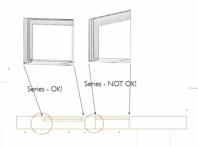

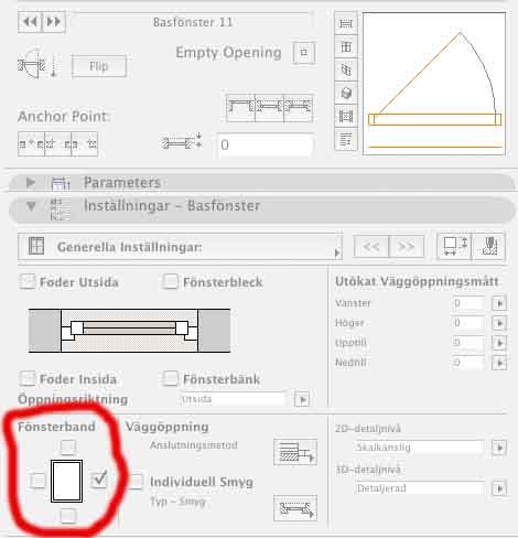

I don't know the right word in english but I've red-marked the setting in the attached image of the settings dialogue for a normal window. The trapeziod window doesn't have this 2D representation for windows connected in series. Bug or feature?
Cheers,
Mats

The word is "Ganging". Load the INT library and you'll find it.
Bug or not, I guess the feature has to be enabled in the library part. And this one doesn't have it.
Mats_Knutsson
Mentor
In AC 11 the ganging works if there's another window to gang up with. There's is no ganging alone. I guess it's the way it should be...
