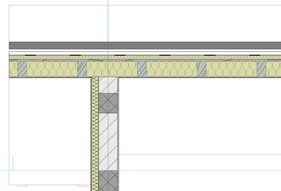

I need advice with trimming the walls with roof in such a manner that I get a correct gable detail out of the box.
Here is my situation:

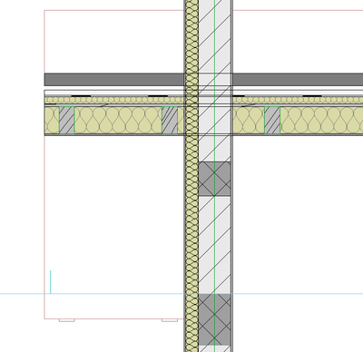

If I do the connect/trim elements to shell/roof i get the following result:
As you can se the trim is not correct because the wall should trim to the bottom insulation layer of the roof and not to the roofing layer.

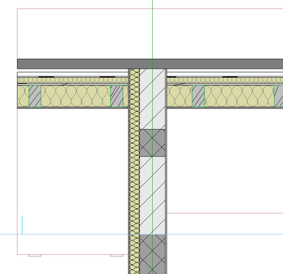

If I do this via SEO (subtraction with upward extrusion) the result is a bit better but not completely:
Walls now trim to plasterboard lining. How do I achieve the desired result where walls would intersect the plasterboard's and end with at the bottom end of roof bottom thermal insulation layer?
Is there a way to numerically adjust the trim in vertical direction? Or can I control at which skin does the trim end? Does the "Type" parameter inside the Composites settings control this maybe?

Solution
With the connect/trim method, it relies on the strengths of the building materials you use in the composites.
Stronger BMs will cut weaker ones.
So the insulation BM needs to be stronger than any of the BMs in the wall.
You may find your self needing multiple insulation BMs - i.e. roof insulation (which is stronger) and wall insulation.
You might get away with the ceiling (roof) plaster being the same BM as the wall plaster.
With SEO, the wall will trim to the underside of the roof with subtract with upward extrusion.
And it will trim to the top of the roof if the wall is above the roof (trimmed with downward extrusion).
Building material strengths will not come into play.

We found that modelling the bottom (ceiling) finish seperately from the 'structural' part of the roof meets classification standards better and makes using SEO with upwards extrusion correct for the majority of connections.
Might not be the answer you were looking for, but it solved a lot of these connections for us.
