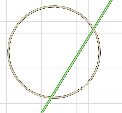

I'm posting this to ask how can I trim a circle. I tried using the trim command as well the (command-click) but for some reason the trim is not working. I have a circle wall with another straight wall crossing in the circle. I want to trim one side of the circle, so that the wall ends up with one straight edge and the other is a curved wall. I attached a pic to make it clearer.

Cmd+click should work though you would need to do it in 2 steps

or you could use the Split command by selecting the circle and go Edit->Reshape->Split, click on the wall, select the side you want to erase and hit delete.
Sounds like a lot of steps but is fast

Your circle may be grouped. If it is, Suspend groups then you will be able to trim using Command Click method.
It worked. Thank you
