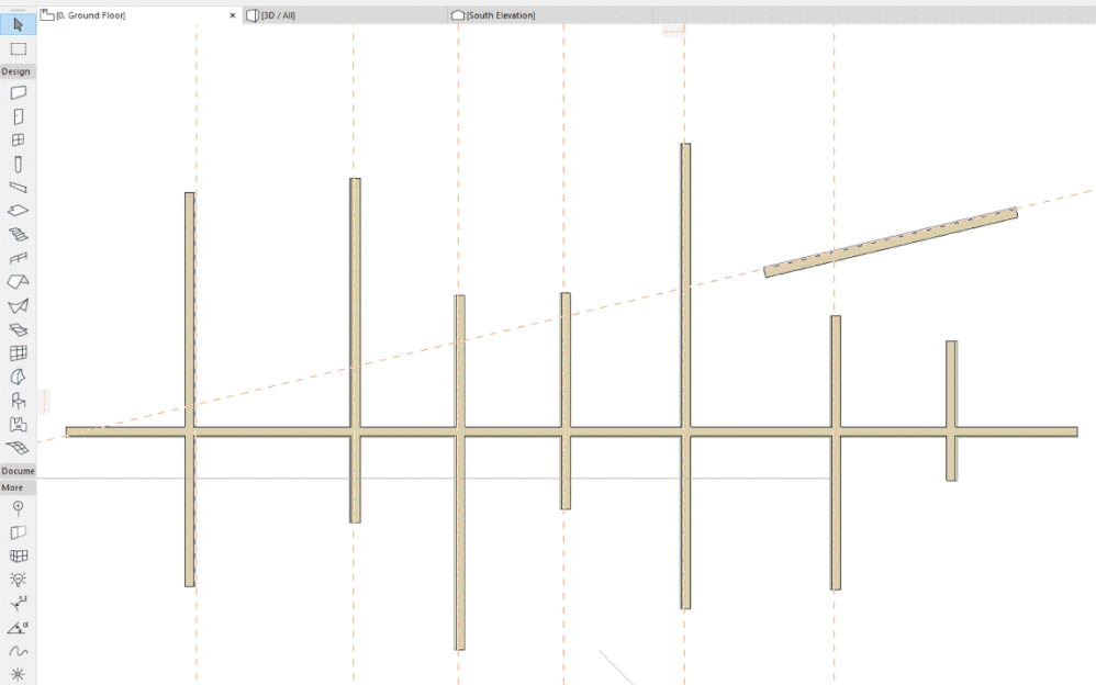

Trim function helps you to edit the existing elements quickly and easily in 2D and 3D. This is done by CTRL-clicking (on Windows) / CMD-clicking (on Mac OS) elements on the Floor Plan. One can cut off unneeded portions of Walls, Lines, Arcs etc., split them in two pieces or extend them to another element. It can also be used to create Hotspots at the real or imaginary intersection of Elements.  However, what ARCHICAD does will depend on several factors, including the number and types of elements selected and the Tool activated when the CTRL/CMD-click occurs.
Click to see the possible combinations:
Arrow Tool is the currently activated Tool If there are no elements selected, then CTRL-clicking on any element will trim that portion of the clicked element to the closest intersection point in both directions. The Black Scissors appear on top of element edges, while the white Scissors indicate empty space.
If there are any elements selected, then ARCHICAD will consider only the selected elements for possible intersection with the CTRL-clicked element.
Selected Element's Tool is the currently activated Tool If there are no elements selected, then CTRL-clicking on any element will give the same result as if you were using the Arrow Tool.
If one element is selected, CTRL-clicking the element will not result in any trim action.
If several elements are selected, these will be split in two along the CTRL-clicked element if they intersect with it, or the selected elements will be extended to their imaginary intersection point with the CTRL-clicked element, in case they do not intersect.

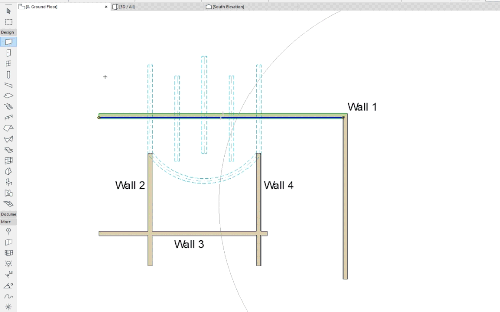

Currently activated is the Hotspot Tool If there are no elements selected, then CTRL-clicking on any element will give the same result as if you were using the Arrow Tool.
  If one element is selected, CTRL-clicking the element will not result in any trim action. CTRL-clicking on any other element will create a Hotspot at the intersection of the selected and the CTRL-clicked element, if the two actually intersect, or Hotspots will be created at their imaginary intersection point, in case they do not intersect.
If several elements are selected, Hotspots will be created at the intersection of each with the CTRL-clicked element if they intersect with it, or Hotspots will be created at their imaginary intersection point with the CTRL-clicked element, in case they do not intersect.
Note:
  • With the Arrow Tool and the selected Elements' Tools, the CTRL-clicked element gets modified (split, trimmed). With other Tools selected, the CTRL-clicked element is the one doing the splitting/trimming.
  • When a construction element (specifically Walls and Beam s) is trimmed/split/extended, it is done so along its ReferenceLine . Where its reference line intersects the other element is the point where the operation occurs. When the CTRL-clicked element is the operator element, its clicked edge is taken into account. So a Line can be split by the Reference line side of a Wall or its side opposite to its Reference line side.
  • Linear elements (Straight Walls, Beams, Lines, Arcs etc.) can be trimmed/split and trimmed to, but Polygonal elements (Fills, Roofs, Slabs etc.) can only split/trim by their edges. For this you may use the Split command of the Edit menu.
