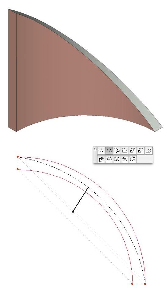

Ok here u got a picture .. I've made them with stairmaker.. i want to make it somehow so the wall will be trimmed to the bottom of the stairs

Hi Roody,
why don't you use the mesh tool instead of a wall. No need to trim and height is easily adjustable if need be.
Just a suggestion. Well, that's how I usually do it anyway...
Cheers
François

Hi Roody,
how much smoother can it be 😉
François

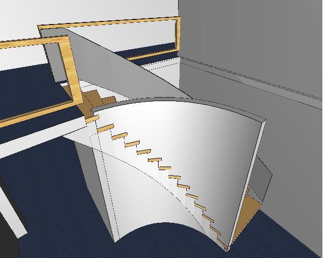

RoodyHood wrote:
Hello...
Ive got a problem with trimming the wall to the stairs.
I've got a similar problem in AC10. I want to create a 5'-6' tall thin wall/screen like Imago that will essentially sit on top of the circular stairs, outside the handrails, kind of like a second handrail. It will need to be trimmed at the base to the stairs - and also needs to have the top line follow the upward curve of the stairs as well, so that it maintains a constant height from bottom to top. IOW, I essentially want an angled panel sitting outside the handrail.
I haven't fully decided if I want it to step up step-by-step with the stairs or not, but I'm thinking I might prefer to have a smooth line both top and bottom, and mount it a few inches above the treads on legs.
Any thoughts on how to accomplish this?
The stairs are built in ArchiStair.
