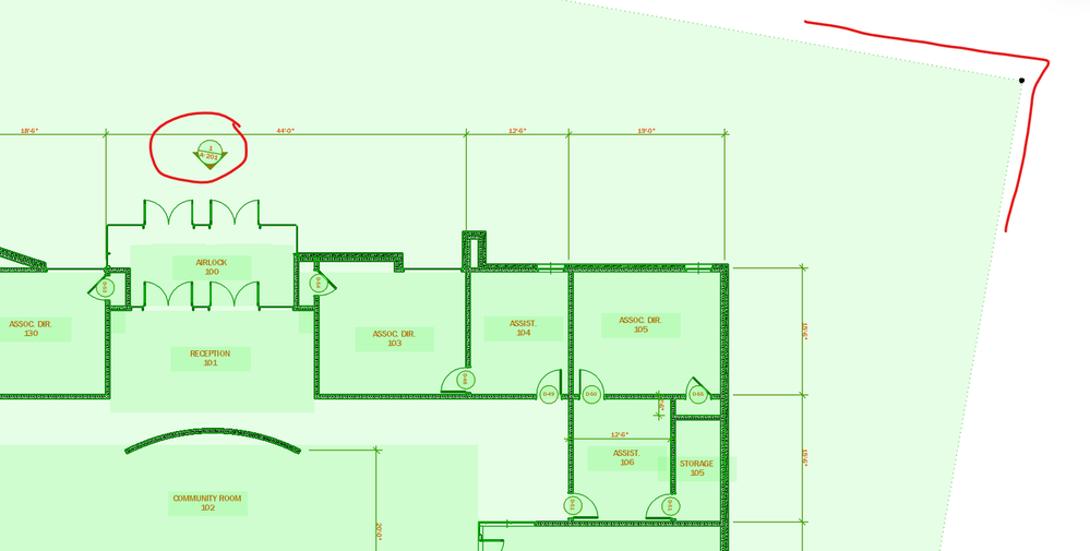

I have a project with 3 buildings at 3 different orientations on one site. I would like to have all buildings orthogonal to the layout. When I rotate the view on the layout the markers do not stay horizontal. What is the best way to make each plan orthogonal on the layout?

3 different buildings, 3 different orientations, 3 different Views. You can set an orientation for each View, which you then place on your Layout.

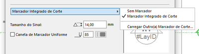

The last AC25 section marker does rotate with the view properly. Is that an old file, or are you using an old library linked in your file? Or maybe a custom section marker which doesn't behave well when the view rotates?
(Sorry for the different language here, guess it's able to figure out)
Have you tried using the default section marker under your section options?
