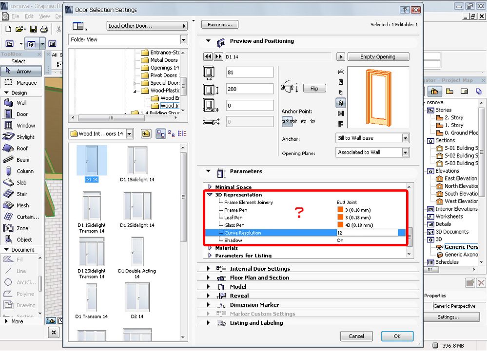

I was wondering if somebody could help me, how can I turn off those orange opening lines on the doors and windows in 3d (or to be precise in Generic Perspective)?
I used to work on Archicad 12, and If I remember it correctly this could be turned off from the Parameters -> 3d Representation options.
Or am I wrong?
But now I am working on Archicad 14, and I can not find that option.
Any help?
Thank you.

It is a global setting now, check "Model View Options".

So what I need is:
Documents -> Set model view -> Model View Option -> Options for GDL Object (ArchiCAD Library 14)
Thank you ejrolon.
