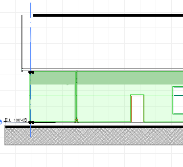

Michael:
If you are referring to the vectorial hatching (fill) on the wall's surface, go to Elevation Settings > Model Display > Uncut Elements > Vectorial 3D Hatching. The Surface needs an associated Vectorial Hatching set under its Surface Settings.

If you mean you have turned the INFO BOX off then you will find it in the WINDOWS > PALETTES menu.
Or you could re-apply your Work Environment to reset all palettes, toolbars, keyboard shortcuts, and many more settings all at once.
Or you can re-apply sections of the Work Environment such as just the Palette Schemes.
