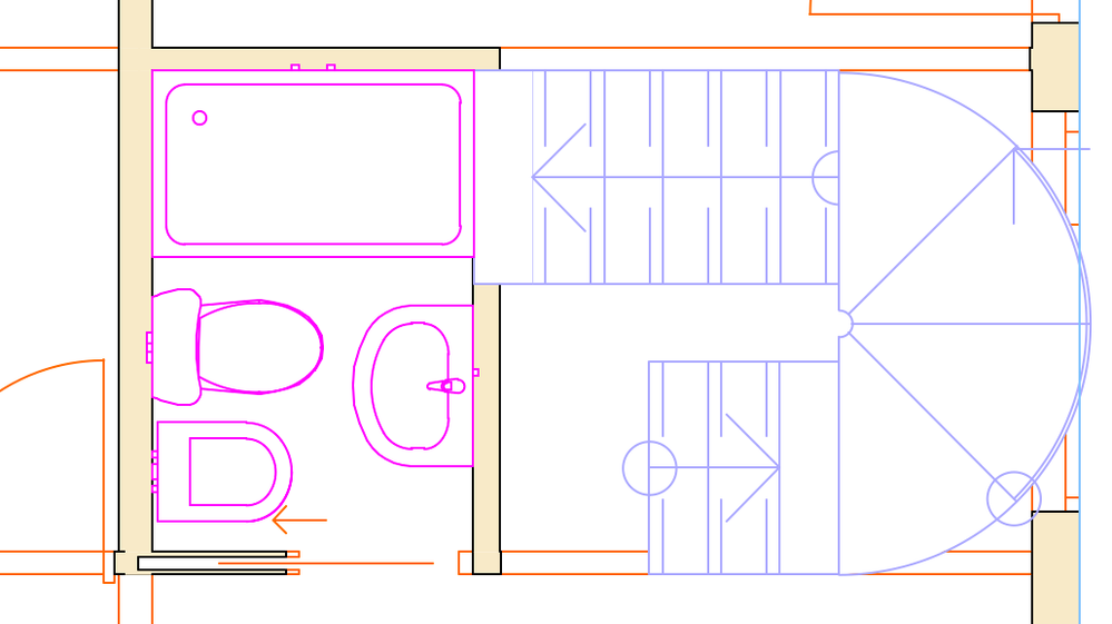

jacobidiego wrote:Ethier use fill to hide what you want to (juggle display order so stairs are behind the fill and the fill is behind everything else) or hide the stair in a layer that is only shown in 3D and sections. Then draw the stairs in plan with lines.
The problem here is that the circular shaped stair is crossing the wall and I can't find a way to hide this from the planview.
Do you know how can I solve this?
jacobidiego wrote:Make a wish in the wishes section of the forum - you never know what might happen.
PD: Why is it that stairs don't just follow a polyline?
2017-01-31 01:54 AM
2017-01-31 02:13 AM
2017-01-31 05:21 PM
Barry wrote:Uff, I have done that several times in my time working in Archicad, and that is one of the reasons why I made these wishes
Use the slabs in a layer that only show in 3D, sections and elevations.
Hide the layer in plan and draw the steps how you want them with lines.
This is not the ideal solution (that is to have a stair do exactly as you want) but sometimes you have to resort to this.
