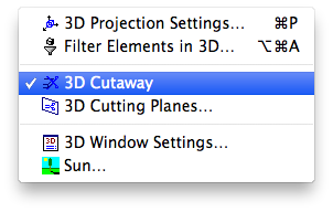

Right clic on 3D in the navigator and check if 3D cutaway is off
