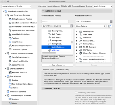

ptaylor:
The command you need is No CC Subtypes.
David

Check out your work environment?
Options => Work Environment => Toolbars => All menus in alphabetical oder => Save Selection As...

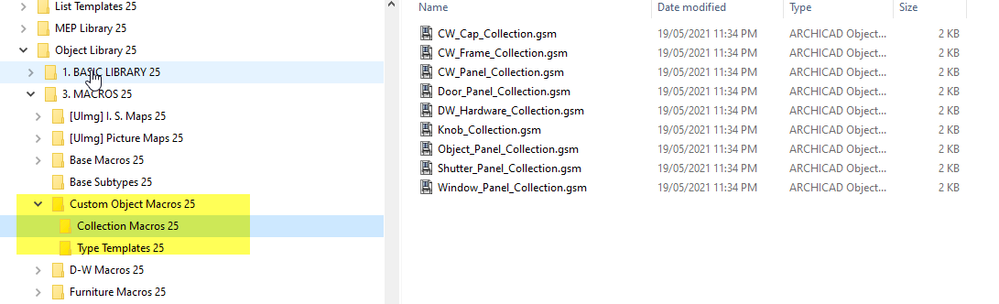

What I discovered was this issue only occurred when I opened an archive file and read the objects directly from it. When I opted to extract the objects to a folder on the hard drive, the issue went away.
There is a macro folder in the library that contains macros for the 'CC" (Custom Component) types.
I guess they weren't all included in the archive library.
ptaylor:
Thanks for adding your signature. I think Barry is right, the standard ArchiCAD library needs to be loaded for these commands to work.
