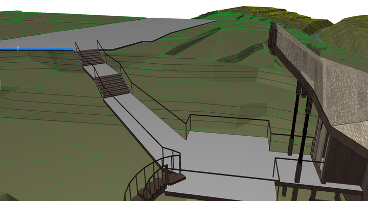

I opened my model and suddenly a bunch of my layers were turned off (which I turned back on), and my floors are suddenly greyed and trimmed 100 mm. I have tried turning on and off, removing all trims, etc, but nothing I can think of seems to work. Why is this happening?? Please help, I am on a deadline 🙂 🙂

have you checked if there are any other elements interacting with your floors?

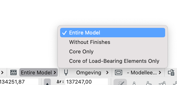

It could also be that you have activated the core only...
