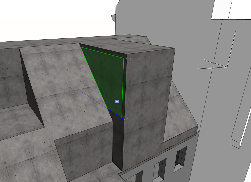

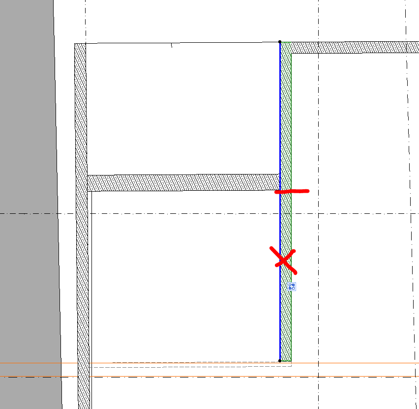

Hi everybody, we are designing a building with pitched roof and wall connections, where the bottom parts of the walls are trimmed. Is there any way to hide the trimmed part of the wall on the floor plan?
1 Solution
 Unfortunately SEO is not reflected in Floorplan so I recommend as a workaround which will give you the same result you can use polygonal opening tool rather than trim to roof then you can adjust the opening to have no symbol, no reference axis and no cover fill.

Thank you! Great idea! We are stuck in AC24 because the project, but I was able to replicate your solution with a custom window.
Another option is to split the Wall into two, trim both with the Roof, and change the Floor Plan representation of the overhead Wall segment to "overhead". If you do not want to see it on the Floor Plan, you can even place it on a separate Layer and hide that Layer.
