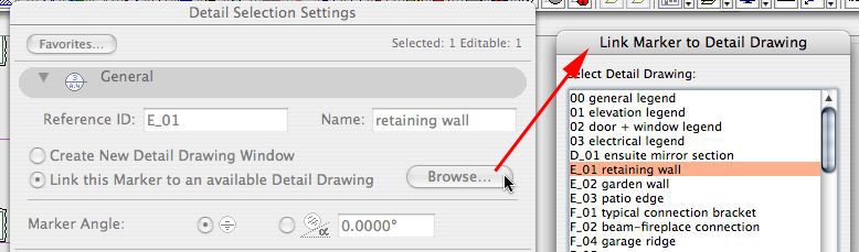

I was referring to an existing detail marker. Since it has that checkbox in the info box, I had always ass-umed that I could unlink the marker from its detail --to keep the marker as a dumb marker (in this case I decided the enlarged floor plans will not be details after all, but a different view of the floor plan, and I don't want to re-do the marker), to keep the detail as a dumb detail, or to unlink and re-direct in the way you can do with drawings in Plotmaker.
The checkbox seems to be always grayed out though.

there are two main types of detail: those that have original content and those that are merely pointing the way to those details with original content. if your detail is one of the latter it can only exist if it's pointing to something. hence not allowing it to be 'unlinked': it would disappear into thin air ("help! my marker's disappeared!") ...
... however: you can re-link it to another detail but the process does not involve firstly unlinking it, but simply changing the link path with the 'Browse' button . . .

and from the info box.........>
(ignore the marker name to the left of the 'browse' button: this is a bug and should be displaying the name of the detail that is being linked to . . .)
