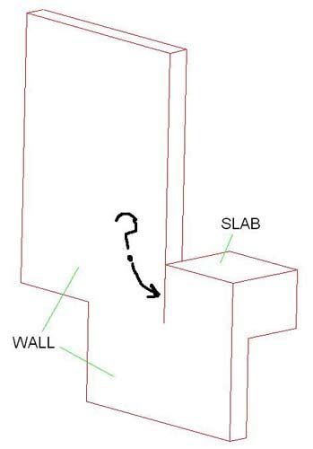

See attachment. I would like to get rid of the little line where the wall meets the slab. I somewhere feel I should know how to do this but I can't so please help! Materials are the same, pen colours are the same.
Best regards,
Mats

Maybe the connection of the upper wall with the slab is not accurate
What about if you break the upper wall to 2 different walls at the level of the slab?
Mats,
I have noticed that I am unable to make the side surface
of a slab clean-up with a wall. The top edge and the bottom edge
always clean-up but never the sides.

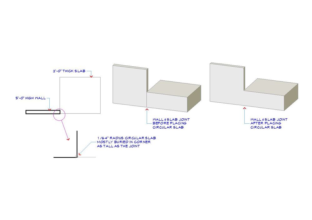

Mats,
You asked, "how 2 get rid of?"
One way is as described below (see attachment).
Please note that circular slabs always have a minimum
of two vertical "edges" so you must orient the slab
so that these "edges" are buried.
Peter Devlin

That was a really shrewd (do I spell it like that?) work-around! It doesn't work all the way though. When I export it to dwg there will be some small annoying lines left. I don't know if it's a bug or if it's a decision from GS not to let the wall clean-up with the slab side. I will post lettter to GS and ask them. Thanks anyway for the tips!

You can replace Wall #3 with Column or Beam and must overlap wall #2, then the clean up is fine!
