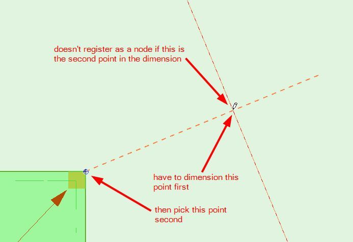

matthewjj wrote:The perpendicular guide line only shows up in relation to an other guide line. So the exact process in ArchiCAD 14 to show a guide line perpendicular to a slanted angle wall at it's midpoint was:
...but I used to be able to just go to the mid point of anything and then a perpendicular line would pop up immediately. Now I have to hover on the edge, press the little circle thing, go back to the mid-point and then it will show me the perpendicular guide.

matthewjj wrote:Strange I have Ctril+` as the shortcut and it works fine.
[ONE WEEK LATER]...
… I still think not being able to use the Escape key to get rid of all the guidelines is annoying and I can't seem to get a shortcut to work for the "Remove Guidelines" command.

Gus wrote:Place a guideline on the boundary line first and then place a guide segment from the corner perpendicular to the boundary guideline.
Barry, I could not seem to get that to work.
