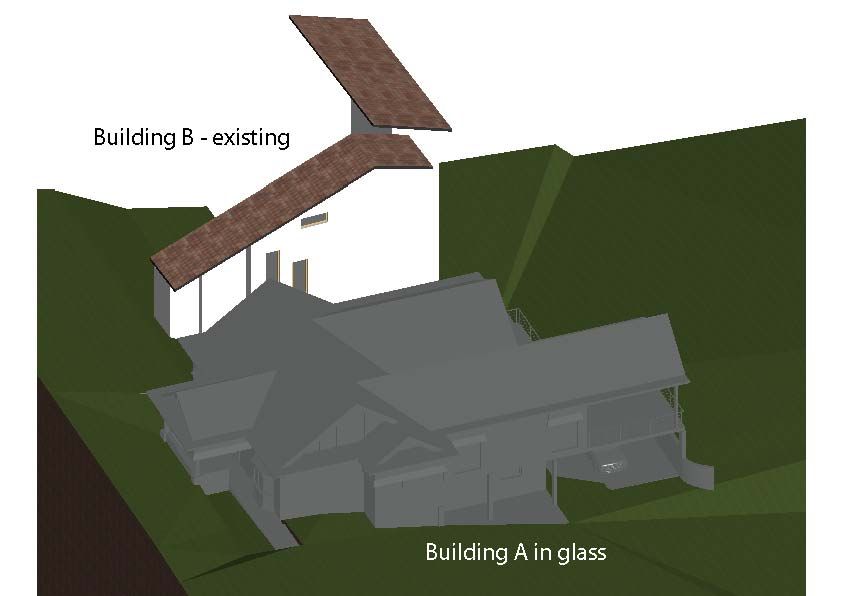

Sorry guys knew I forgot something 😉
Anyhow here is the attached JPEG.
I want to show the effects of the shadowing due to building A on the elevation of building B.

map adjoining property with glass material and turn Transparency in Shading ON in 3D window settings. Put section behind the adjoining property (so you will see the elevation of your building through). Then unlink the section and delete all undesired lines.
So... I take it that I should change all of the material of building A to glass and then put the section line behind it ?
But if I do that, even if the material is glass, in section it'll just become opaque....
I guess it'll work if you render a sectional view in the 3D engine although you can't exactly render at a particular scale.
Hmmmmm....

Turn Transparency ON, but this will of course affect Building B also. And won't you still get outlines of Building A elements if the section line is beyond it?
Okay here's what i did:
Converted the existing building into glass. I think the best way is to save the entire model as a gsm. so then you can change all the material in one go.
It was kinda tricky because you can't save the entire model as a single gsm and I had to do it individually for each storey and then group them together.
