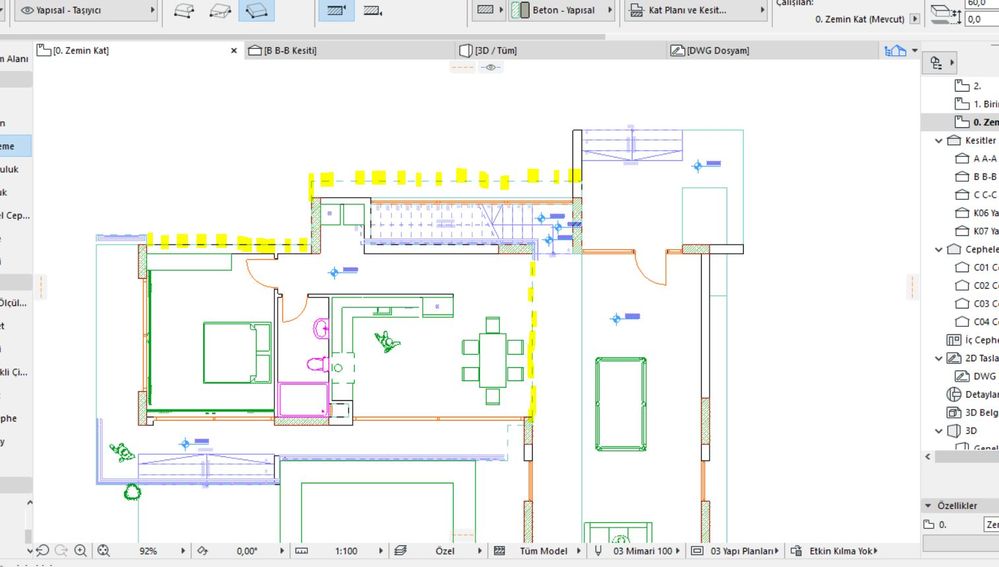

Hi, i have a problem about slabs view on plans. In our architectural standarts when we aer on ground floor plan and if there is a another slab upper level. We want to see it dotted in the gorund plan. Because it is your upper level. In the opposite case if we are wrking on first floor and we are seeing under level a slap. We want to see it thin line. Because it is on lower level. How can i change this settings? You can look the attachment. It is Archicad standart settings. It is showing upper level slap with Dashed line. But i want it dotted line. I hope I can tell the situation despite my bad English.

The line types you describe are controlled from Project Preferences > Legacy.
You can only control the line type but not the colour/thickness.
Graphic Overrides may be another option to get more control.
